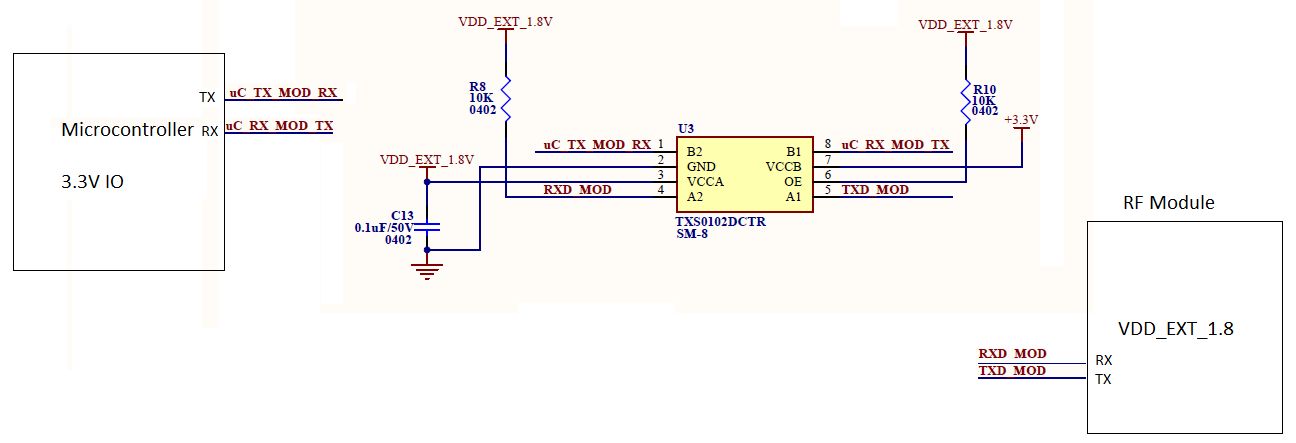

TXS0102: Logic converter SCH Review
Part Number: TXS0102
Hi TI support
I need to interface UART communication between Host uC to RF devcie , both IO level have different voltages. uC have 3.3V IO and RF module have 1.8V IO.
I have selected TI chip  PN: TXS0102DCTR.  see attached SCH and let us know if this is correct for this application
