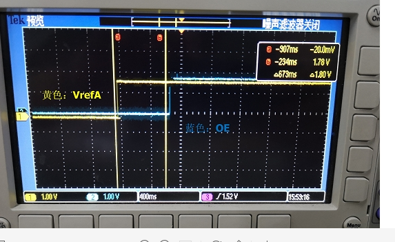

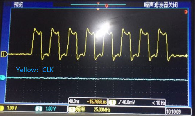

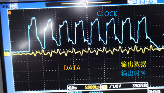

My ctm used LSF0204/TXB1024/TXB0304 as their data buffer.when SPI rate over 20Mbps, they met data error,but less than 10Mhz, it will not happen. The level of OE are set low when power down and on, the error is still exist. the wave form is as follow: Would you pls give some recommendation on this issue? Thanks a lot.
