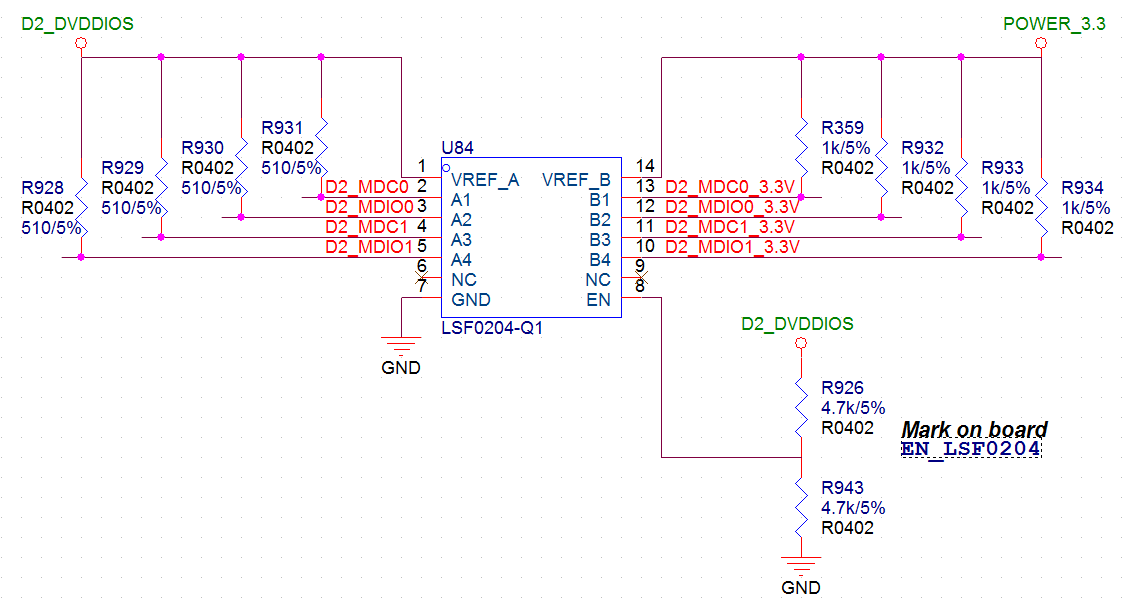

Part Number: LSF0204-Q1
Hi Sirs
We would like to use LSF0204-Q1 for MDIO.
But we don't have samples can test.
So here are some questions I want to confirm with you.
Following is our Application condition
1. DVDDIOS(VREF_A) would be 3.3 V, 2.5 V, 1.8 V, 1.2 V there are transform to 3.3 V (VREF_B)
2. LSF0204-Q1 most be support speed above 25MHz when VREF_A at any voltage level.
The PCB design as following
Is pull-up resistor values meet requirement?
Is any PCB design have problem?
