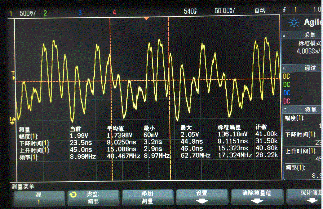

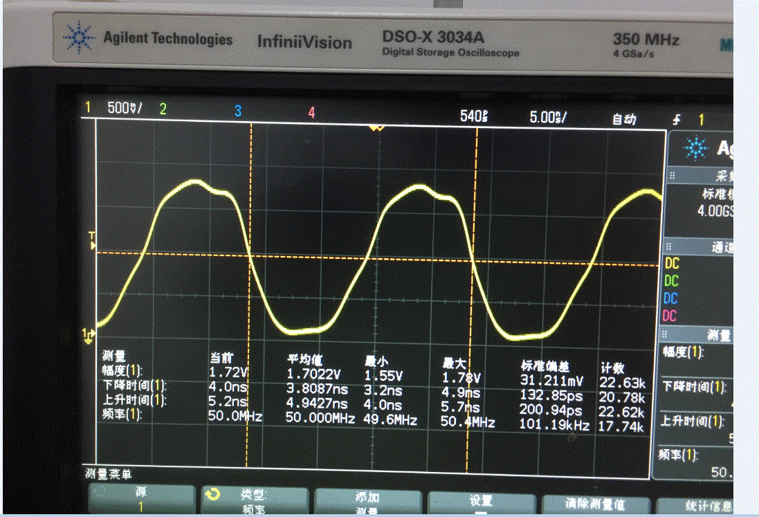

Hi TEAM,
My customer is using the TXS0108 now, B side is 3.3v, A side is 1.8v, B side give the clk to A side, A side is the FPGA.
1. when the clk is 10M,  work well.
2. when the clk is 50M, it doesn't work.
we have checked the waveform of 50M side, it has distortion. What's max frequency our device can support?
