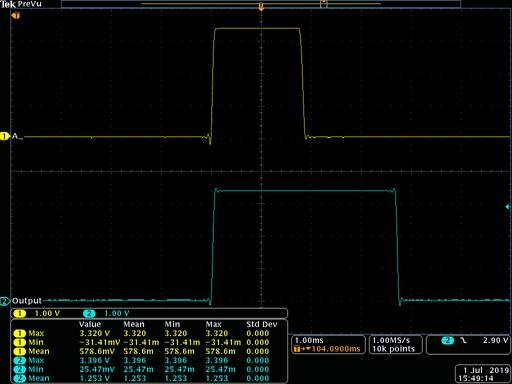

Our customer is using SN74LVC1G123, and below is the schematic:
Ideally, the output Q (pin5) should change form Low to High and produce a pulse when the input A (pin1) in the transition from High to Low, right??
But belows are we measired waveforms:
Sometimes the transition from Low to High of the input A would cause the output Q also change form Low to High.
Do you have any idea about it?? Or any comment??

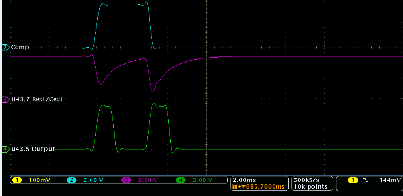

  • Dear Karan,
    Thanks very much for your feedback.
    Now we have removed the external ground, but it looks also abnormal.
    The VCC is stable. Please see the waveform below (pin1, pin7, pin5 respectively). Do you know why Q output a pulse at A's rising edge??
    Is the blue signal the A pin? If so can you zoom into it so I can see at what voltage on A is the output triggering.
    The device has schmitt trigger inputs so it should handle slow inputs but if possible you should speed the signals up.
    Can you also provide scope shot of the CLR and B pins so I know what they are doing when this is being triggered?
    Thanks!
    -Karan
  • Dear Karan,
    We found that the root cause maybe is the signal bounce of input A (the blue signal).
