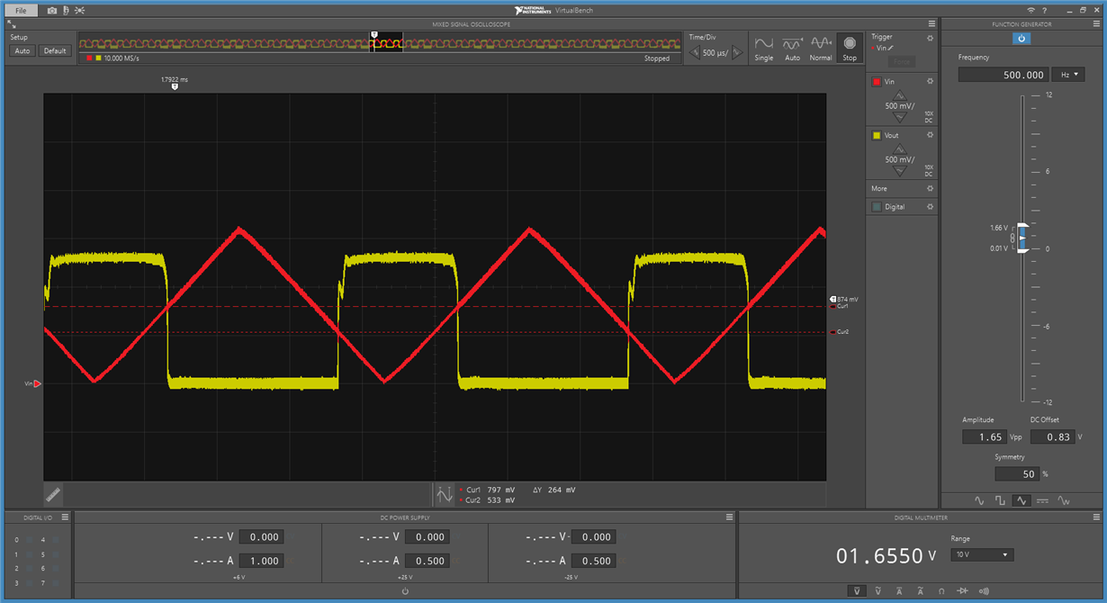

For SN74AUC1G14-EP, I'm verifying the Positive and Negative going input thresholds. I tried to replicate the positive going input threshold for Vcc=1.65V condition, using a triangle wave at the input, and drawing maximum of 8mA at the output, however I saw VT+ was slightly below the VT+ min on the datasheet. From what I understand, this should not be happening.
What is the recommended current draw at the output when testing this characteristic?

  • The input threshold should be completely independent from the output current (this is why the current is not listed as a test condition in the datasheet).
    How much is "slightly"? What is the accuracy of the 1.65 V supply? (If you're using a nominal 1.65 V supply, it might be possible that the actual value is slightly below that. But that should not happen if you're using a lab power supply.)
  • I agree with Clemens, in that the output is independent of the input.
    With the potential exception of GND bounce or VCC droop from high inductance VCC or GND connections and/or poor decoupling.
    Can you post scope shots of the test?  Include VCC probed on the pin of the device if possible.  Use the paper clip icon to attach.
    Wade

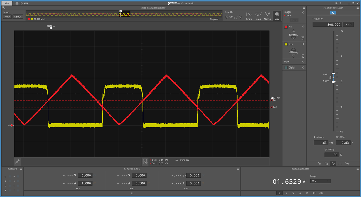

  • Hi Wade and Clemens,
    I believe you're right, the Vcc was slightly below 1.65V which presented with a positive going input voltage below the minimum on the datasheet.
    The resulting scope screenshots are attached for those samples that were previously failing. They're slightly above the minimum 790mV now
