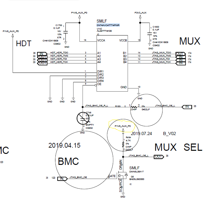

Hi Sir,

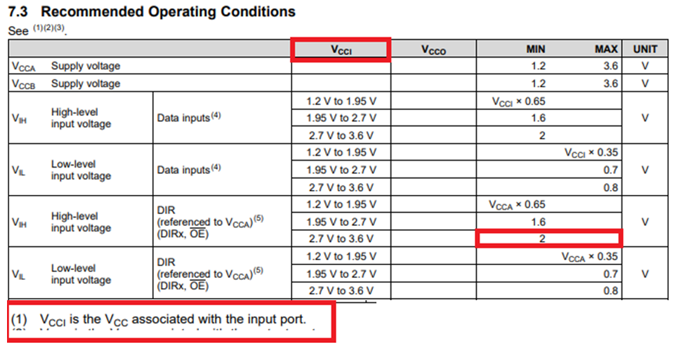

My customer design VccA=1.8V and VccB=3.3V and mentioned that if they connect OE pin to VccA = 1.8V, still can see the port B signal pass through to port A.
But if the change OE pin connect to VccB =3.3V, port B signal will not pass the signal to portA.
do you have any idea about it? any suggestions?
