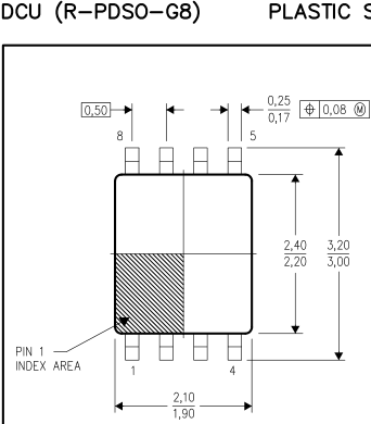

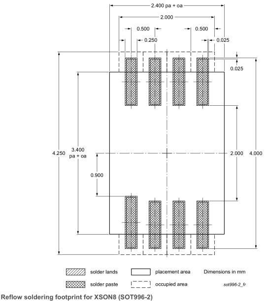

Thank you, Clemens, for the response along with the graphics!
This is helpful information.
