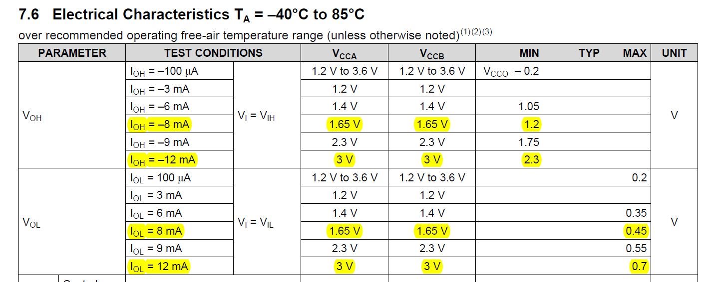

Usually according my experience, the output impedance of logic level is around 25ohm which matches the examples in your FAQ.
According to the ways to calculate the output impedance, Can I conclude that for 1.8V bank, the output impedance is roughly 56 Ohms (0.45/0.008A = 56.25Ohm) and for 3.3V bank, the output impedance is roughly 58Ohms (0.7V/0.012A = 58.3Ohms).
Can you confirm this information? I will attach the table below.
Yes, you can compute the worst-case output impedance this way. The typcial output impedance will be lower.
Please note that the AVC output impedance is not constant; it is lowered during switching (see AVC Logic Family Technology and Applications (SCEA006)).
Once upon a time, TI wrote reports like Input and Output Characteristics of Digital Integrated Circuits at 3.3-V Supply Voltage (SZZA010). But the AVC/AXC families are newer than that report.
Hi Layne,
Yes you've done the calculation correctly, and as Clemens mentioned this is worst case. Since there is margin built into those specs, you can probably shave off 15-20 ohms to get closer to the typical output impedance. I'd say 30 ohms would be a good value to work with when doing your matching for 3.3 V side. And 40 ohms for the 1.8 V side.
