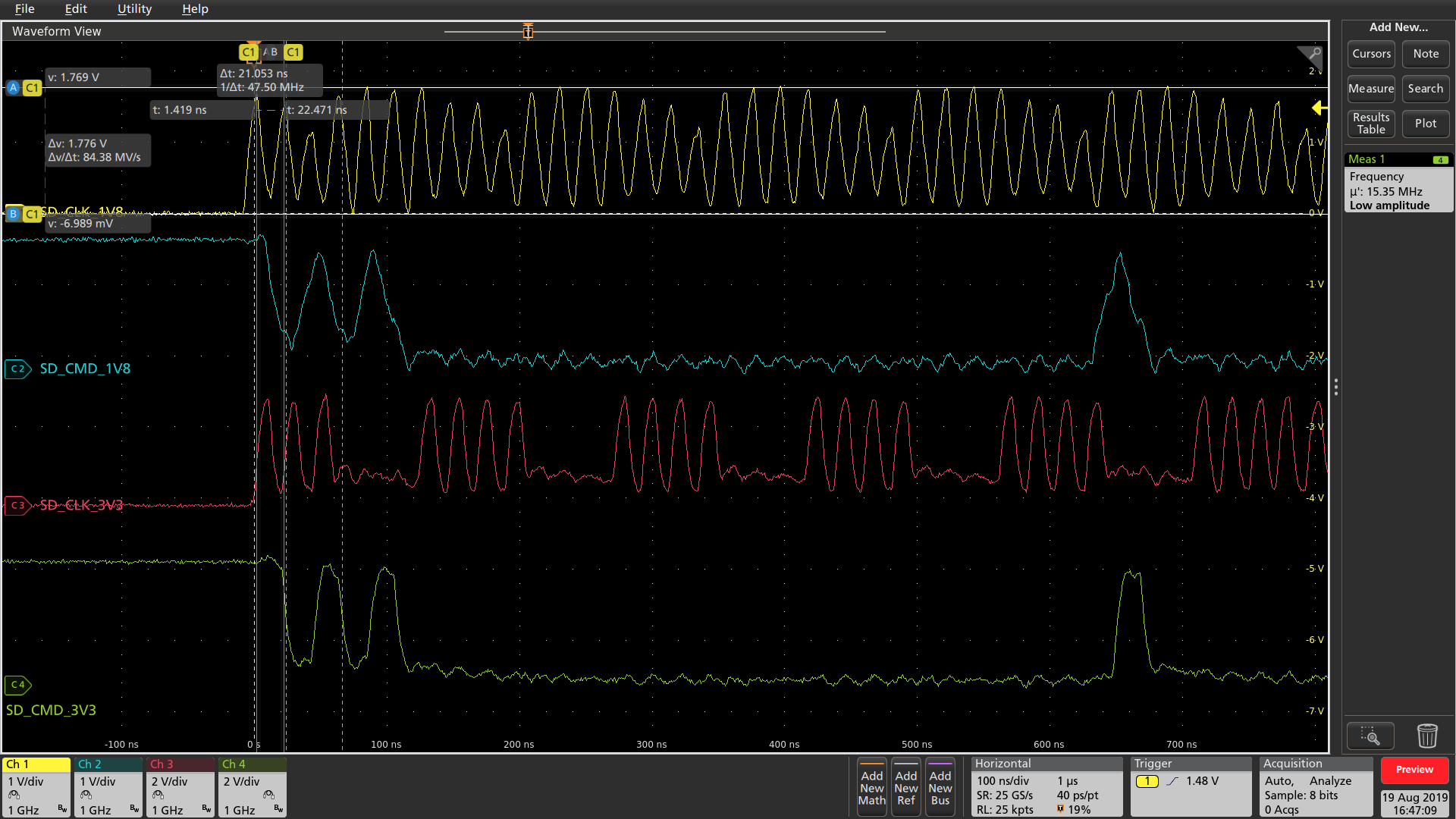

TXS0108E: AM3358BZCZ100 can't boot from SD Card after level were converted from 1.8V to 3.3V
Part Number: TXS0108E
Other Parts Discussed in Thread: AM3358,
Hi
I configed the MMC0 of AM3358 to SD Card interface but power supply is 1.8V to match other functional requirement, used the TXS0108E as voltage translator.
I think the data rate isn't the cause as TXS0108 can up to 60M in my application.
Is it because the Initialization and Identification between it and Host (AM3358) cannot pass? If yes, how can I modify the host driver?
Please help to advise, thanks!
BR
TC Liu
The schematic as below
