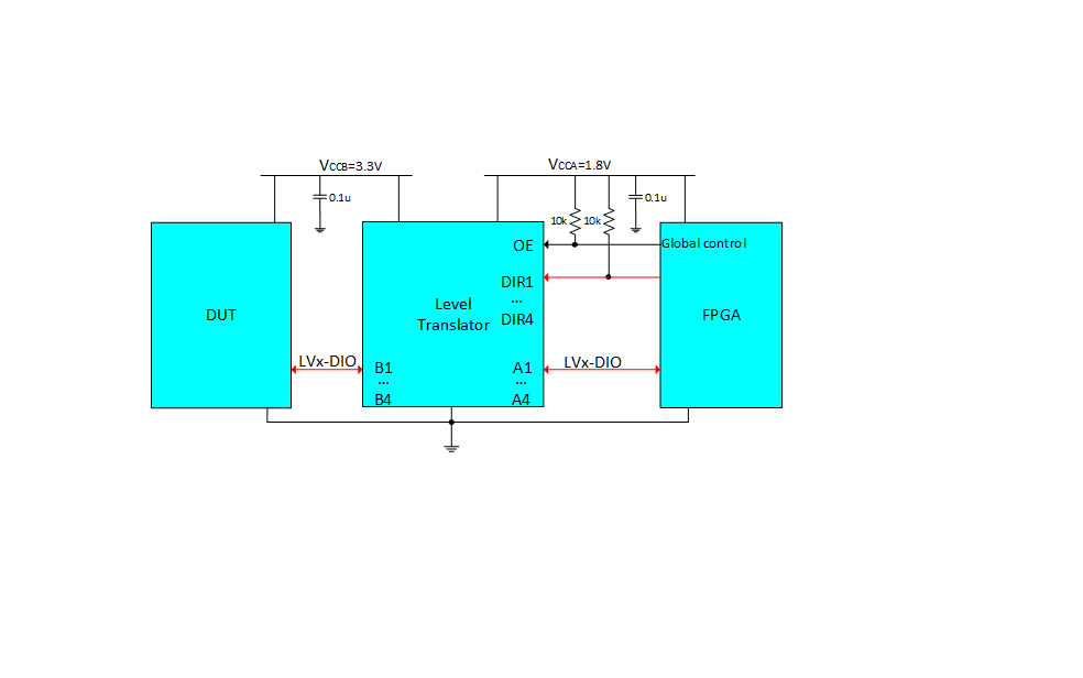

See the schematic above. SN74AVC4T774 is used for voltage shifting from 1.8V to 3.3V.
The requirements of this design proposal:
1. Bandwidth: >50MHz, so >100Mbps.
2. 1.8V is set as the same as the FPGA support voltage. But the VccB should be able to configured for I/O standards from 1.2V to 3.3V.
3. Bidirectional: Independent channel direction control.
4. Interface: 3-state is required in the data chain, because the DUT is unknown. Thus, it can be configured for PU or PD by DUT. The PU/PD resistor is not allowed in the Level translator.
SN74AVC4T774 is available for high speed >100Mbps, 1.2V-3.3V voltage range, individual DIR control pin. Only one OE pin for high-Z set High before power up/down completed.
Requirements 1&2 is OK, but there are some QUESTIONS in 3&4:
3: My design need to read the information back during the data transfer. Thus, the direction will be changed during the running.
In some TI's datasheet, the level shifter with DIR control pin. The device required to disable the device at first, then set the DIR, after this enable the device again. Is it necessary to enable and disable the SN74AVC4T77? Can I set OE to LOW during the normal operation, then during the running, I set the DIR for bidirectional functions without any limitation?
4. I saw some discussion in the forum, the input is always active. Thus, the PU/PD is required for the SN74AVC4T774. Is this used for low power consumption?
But for my design, as we talked before. The logic level should be set by the unknown DUT. It can be High or Low. We can not make a PD/PU on the Level translator.
The worst case will be: direction from DUT to FPGA (B-A), DUT is no signal maybe floating (software maybe can set it for LOW for idle), no PD/PU on SN74AVC4T774. Will this be a big problem?

    I would first like to begin with switching you from the SN74AVC4T774 to the SN74AXC4T774. These devices are pin to pin compatible. The AXC device is faster than the AVC device so it is a better option for you. It also operates at lower voltages in case you might need this.
    Your schematic did not post, can you please provide it again?
    3: It is necessary to disable the AVC device before switching direction. This is because if A side is driving low or high, and direction pin switches from B to A. Then the AVC device would have to fight the device that is driving the A pin low. Now, if you leave the A pin floating when you switch from B to A, then in the time the direction switches, there will high current consumption. The solution is to use the SN74AXC4T774. You just have to make sure there is no signal on the input of the device before changing direction.
    4. Again with the AXC device, if there is no signal or maybe floating, it should be fine. It has some weak internal pulldowns that will help reduce current consumption that is present with CMOS inputs.
    Overall, recommend using the SN74AXC4T774 as it will solve your issues.

  • This level shifter always has a specific direction on each channel, so the output driver on one side is active, and the other device connected to this signal line must not drive it at the same time.
    To disable the output drivers on both sides, set OE low.
    This is not specific to this AXC device; any buffer would have this problem. If the other two chips were using the same voltage, and you had connected them together without a level shifter, you would have the same problem.

  • If and output is driven to a different voltage by another driver, then the current through the output transistor is likely to exceed the absolute maximum rating, and burn the chip up.
    If you expect that this can happen, then you should add series resistors to limit the possible current; 150 Ω keeps the current below 25 mA.
    Thanks for your reply.
    I understand your answer now. Unfortunately, the level-translator is used for high speed line. Thus, the series resistance should not be higher than 50 ohm.
    The output is able to be driven to a different voltage by another external driver.
    A good news is for normal operation, drivers on both sides are set as 12mA drive strength.
    Thus, it should be ok when the bus contention happens.
