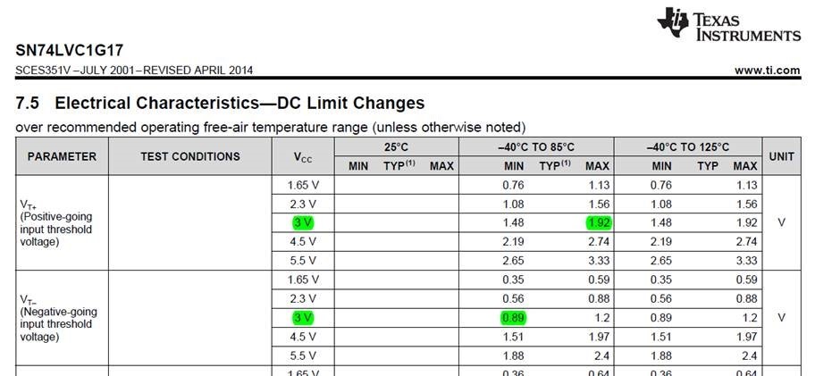

We would like to know is the lowest voltage Vih at the U5 input more than 1.48V at 3V is enough? Or it should exceed 1.92V?

It would have to be at least 1.92 V to get a guaranteed High input.
