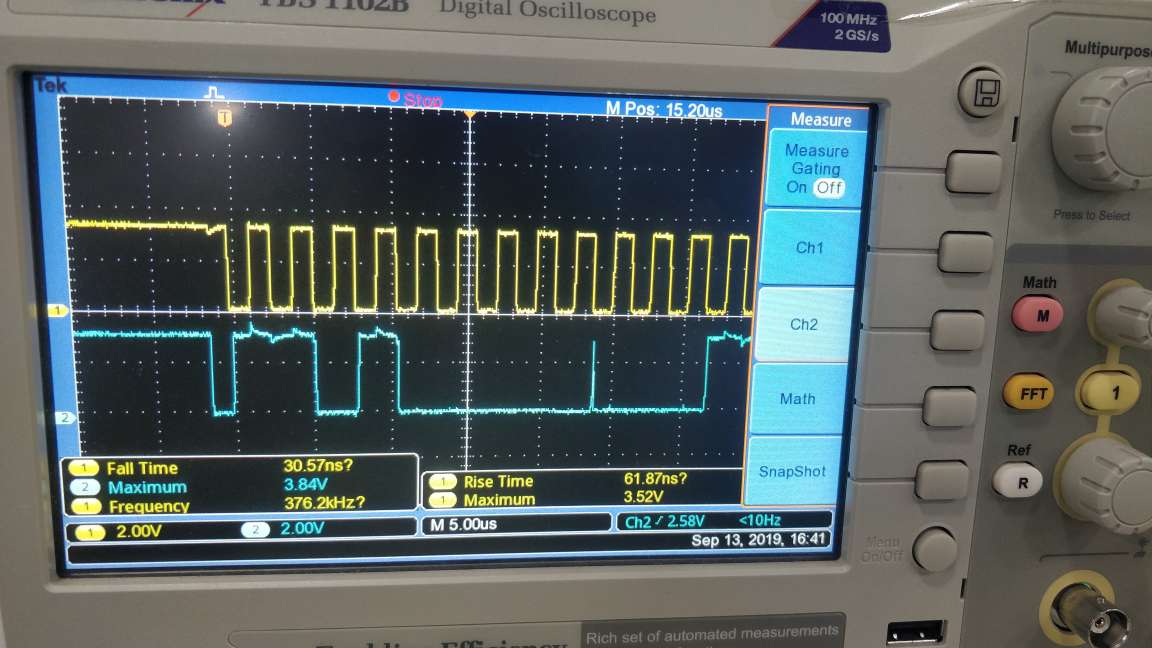

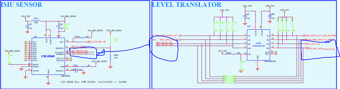

Hello team,
we are using on board 6 I2C slave and one master.
So its working fine, for 5 sensor  out of 6 is used on 3.3V and one sensor is used on 1.8V.
so for that we used TXS0104EPW level translator to convert 3.3v to 1.8v.
1.8v side we have used IMU sensor which part of ivensense part.
While running on long time sometime we are getting I2C timeout error.
Is it because of level translator ??
