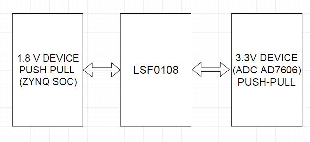

Our requirement is to translate 1.8V to 3.3V (viceversa) between FPGA(1.8V) and ADC(3.3V) device. Both are having Push-Pull outputs.   In Datasheet it is mentioned as follows:
Schematic block diagram is attached herewith for your reference
Please advice if this particular device meets our requirement.(The main reason for going for LSF series translators is extended temperature range upto +125 deg C).
  • What that sentence says it that the two other devices must not try to drive the same signal line at the same time.
    If the SoC implements the communication protocol correctly, then this will work.
