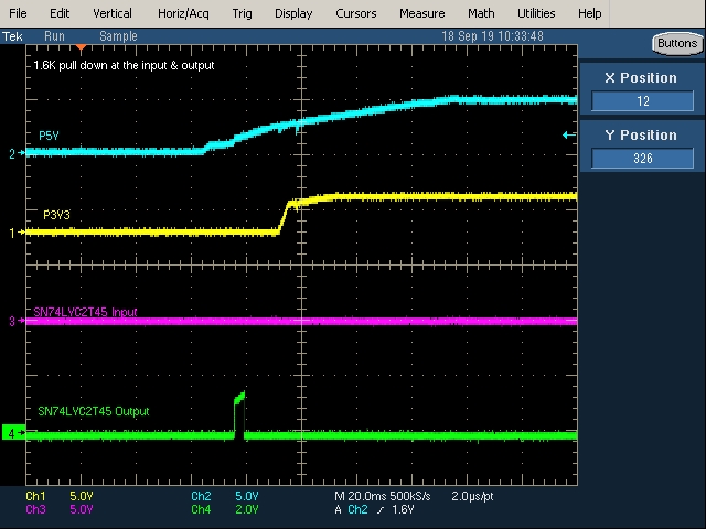

Hello Team,
Requesting your help on this.Our customer is having issues with the SN74LVC2T45 output. The device are used to translate signals from 3.3V to 5V level. However, output spikes appears upon its power-up.
Attached are waveforms and additional information.
He confirmed that they have followed the correct supply and power-up sequence recommendations given on the datasheet.
We would really appreciate any help.
Jejomar
SN74LVC2T45 spike issue.pptx
