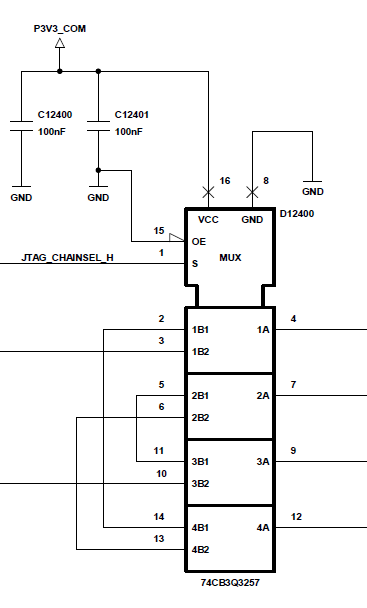

Hi Team,
Please recommend a MUX solution or chip for 1.05V voltage level signal, similar to 74CB3Q3257, 74CB3Q3257 is adapt to the 3.3V signals,thanks.

The control signals must have at least 2 V for the high level.
The I/O channels allow any voltage between 0 V and 5.5 V.
How about using the TMUX1574. It has the same configuration as 74CB3Q3257 but has wide operating supply of 1.5 V to 5.5 V and can pass signals above supply up to VDD x 2, with a maximum input/output voltage of 5.5 V.
