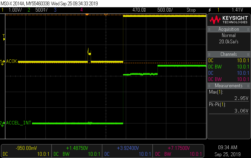

  • Please show oscilloscope traces of the ACCEL_INT and ACOK signals when a working chip is switching.
  • Below is the waveform fo the ACOK and ACCEL_INT from pass unit.
    system off -> TXS0108E disable -> ACOK=ACCEL_INT=low -> then plug in AC -> ACOK become high -> system turn on -> TXS0108E enable -> ACCEL_INT become high.
    This is the correct process. But if using failed unit, ACOK and ACCEL_INT always keep low.

  • Hi CK,
    Can I see the same waveform but with the OE signal probed as well. And then can you also replicate the same scope capture with a device that isn't working? I'll see if I can see anything going wrong, but so far nothing stands out.
