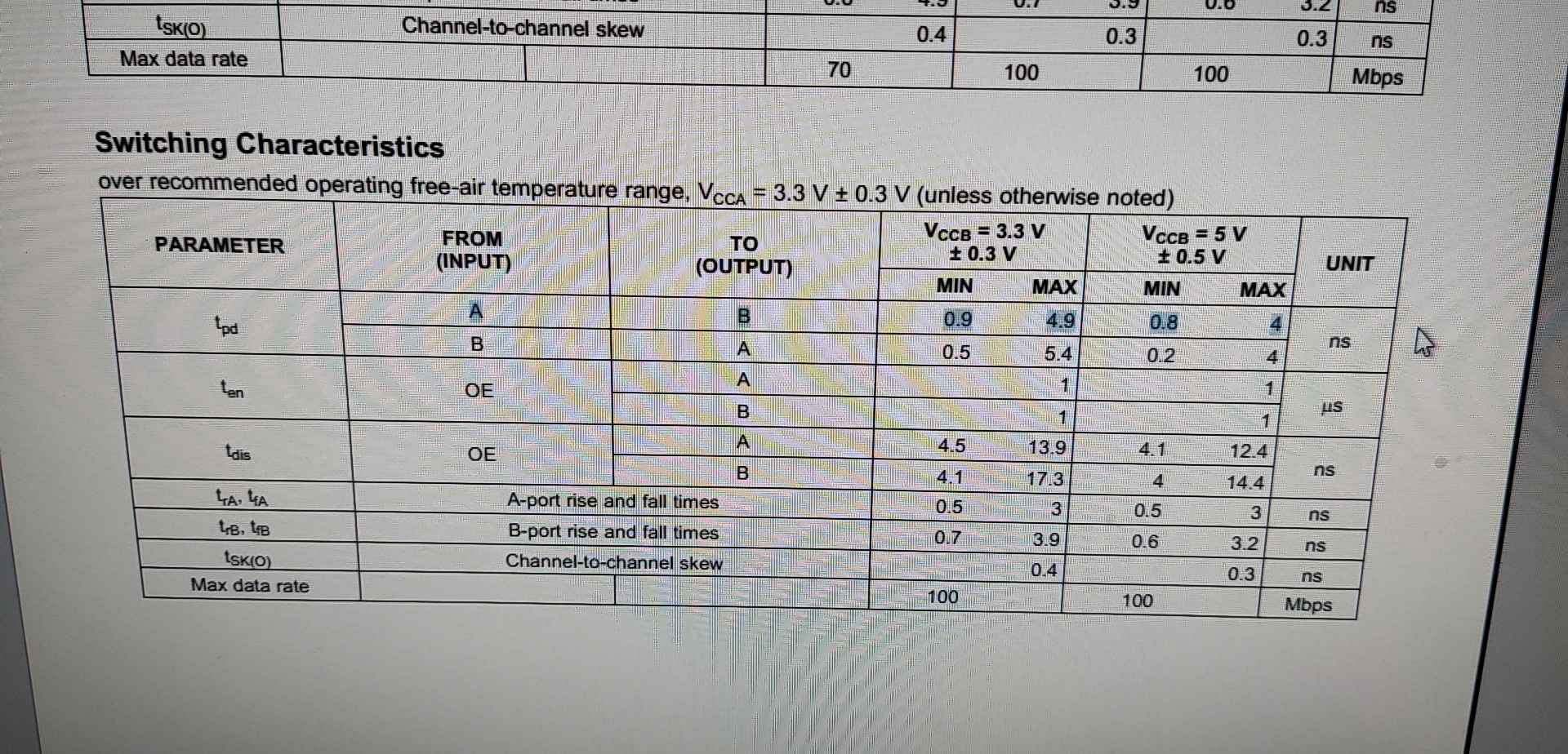

I tested the TXB0108 and found that the tpd is more than 4ns. Please refer to the parameter as attachment. Could you please tell me that if all the chips are tested by factory?

Hi Kevin,
As Clemens stated, this is data for a 15 pF load. It's likely that your load is greater than that causing longer Tpd time.
