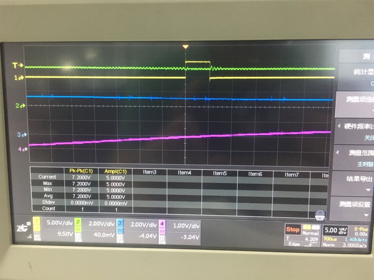

the OE PIN is high ,5V.
the wave : red is output pin B5 ,the green is output Pin B6 ,
What is the yellow channel?

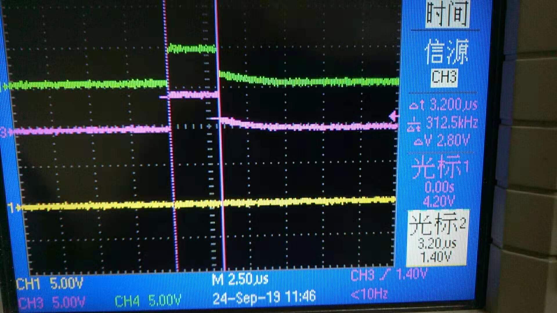

How is the ENABLE signal controlled? Can you show waveforms of ENABLE and VCCB?
the channel1 is B5 ; the channel 2 is VCCB ; the channel3 is Enable ; the channel 4 is VCCA.

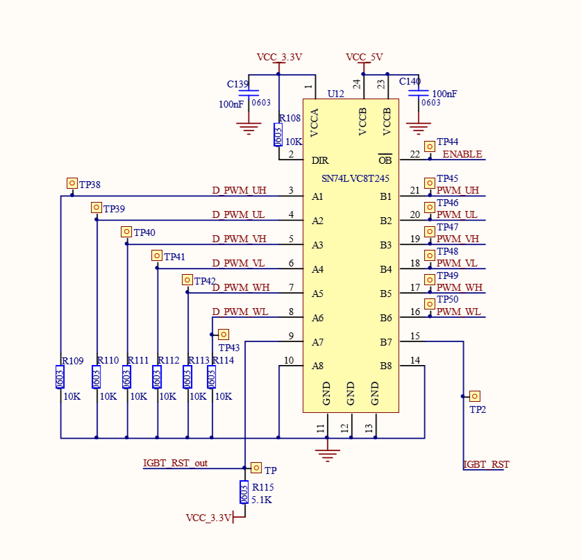

The architecture of direction controlled level shifters can cause the device to glitch during power-up. It has to do with how and when the control circuitry gets powered. The direction circuitry switch a certain port to an output can cause this pulse.
Are you able to power the VCCA side before the VCCB?
