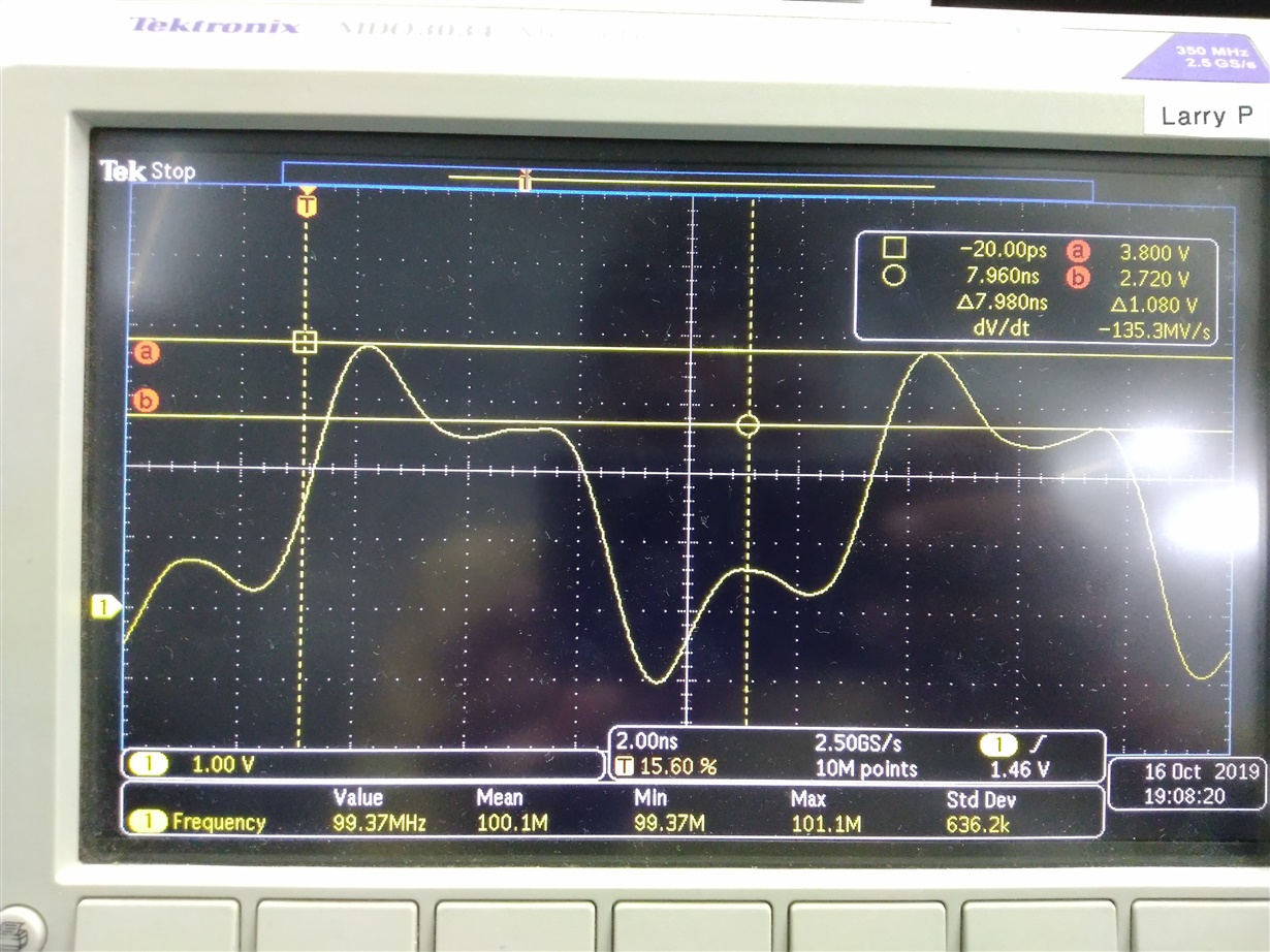

  • Hi i am getting undershoot and overshoot with load and without load.

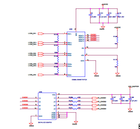

    i have used DS90LV048ATMTCX with converts Lvds to Cmos and then cmos apply to SN74LVC125APW.
    i have connect 49.9E at output of DS90LV048ATMTCX and then apply to SN74LVC125APW. I am not getting undershoot and overshoot at input of SN74LVC125APW but getting undershoot and overshoot at output of SN74LVC125APW.

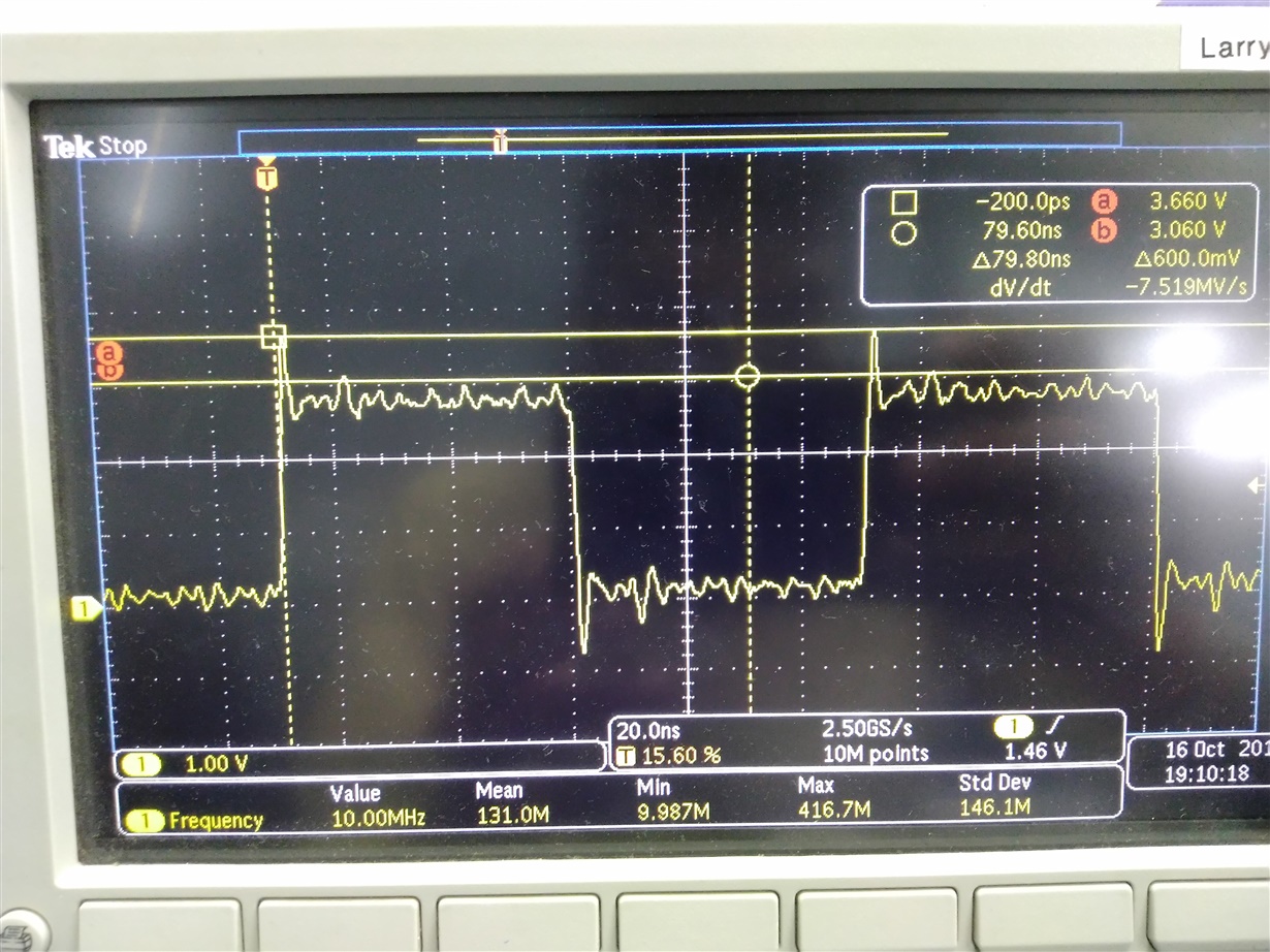

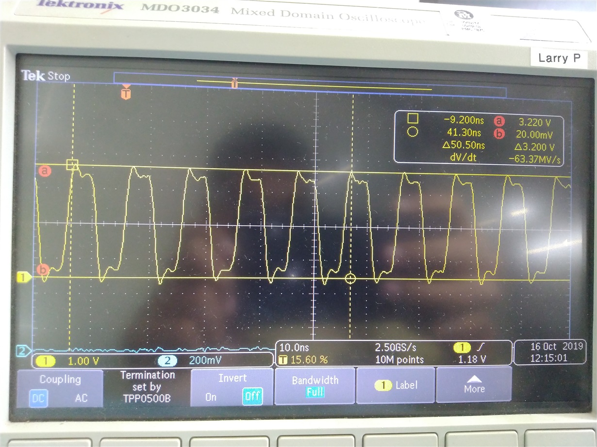

    I have attached the schematic and all waveform are measured with spring.The waveform attached with load of 180mA with 180E resistor load. which kind of load can i connect to the circuit can you please let me know. the wave form are attached after removing 22e series resistor at SN74LVC125APW output.
    The first waveform measured at input of SN74LVC125APW and vcc is 3.3V & frequency 100Mhz.
  • How long are the traces connected to the outputs? Is there anything else that can introduce a capacitive load?
    Do series resistors (22 Ω or higher) help?

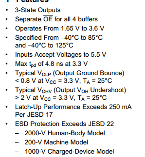

  • In datasheet specified of undershoot and ground bounce. Does this ic will not give the output without undershoot or overshoot.
  • The low output voltage is always below 0.8 V, and the high output voltage is always above 2 V, so this matches the datasheet specifications.
    Overshoots and ringing are caused by capacitive load and reflections. Usually, a series resistor to match the line impedance helps.
