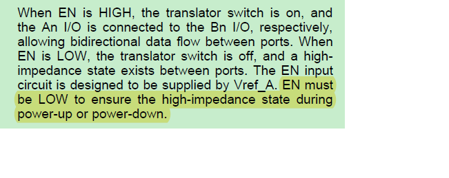

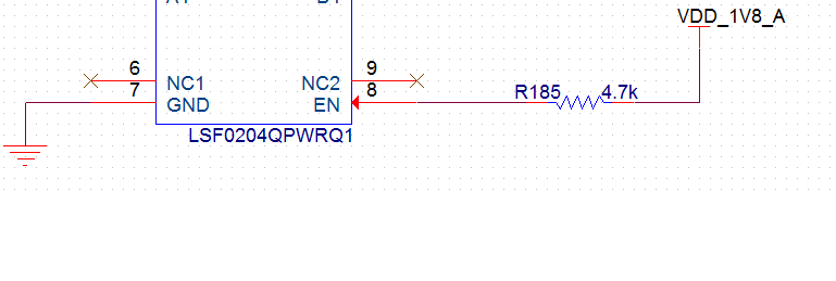

I have a question about LSF0204-Q1, I want to pull up the Enable pin to Vref_A directly, and no other signal will control this pin again.
I 'm not sure wheter it's ok, because  on Datasheet Page 1, it says that:"EN must be LOW to ensure the high-impedance state during power-up or power-down"
Thanks ,
Regards.
