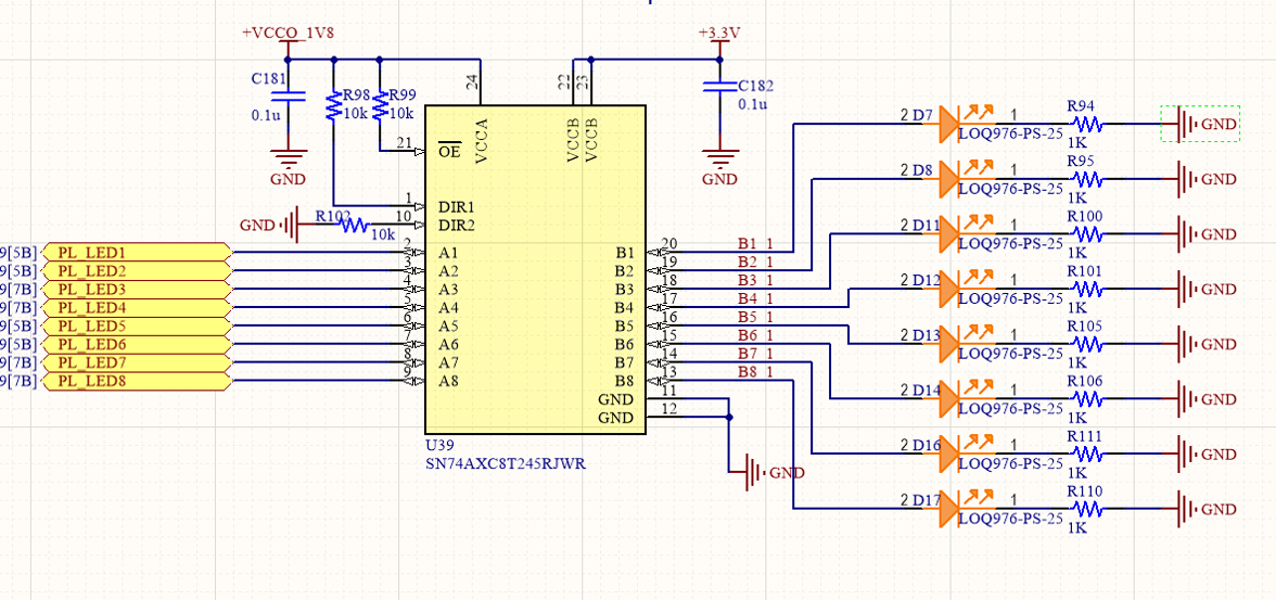

SN74AXC8T245: can this device run 8 LEDs?
Part Number: SN74AXC8T245

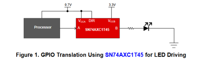

I am using this IC in a new design as pure voltage translator. Reading the documentation for its evaluation board I saw an application as LED driver from a 1.8V GPIO and it is quite neat.
Is it possible/recommended to drive up to 8 LEDs? The total current through the LEDs is well below the 50ma maximum current stated in the datasheet.
This is what I am trying to do to be precise. Is it advisable?
Thanks a million.
