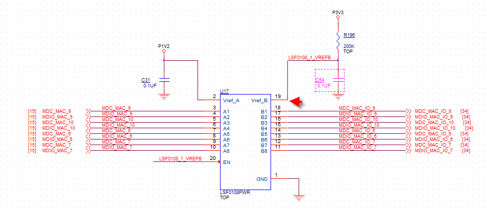

Hi Sir,
Below is my customer's design and they measurement
Pin 19 = 2.012 V
Pin 2 = 1.193 V
Can we adjust R196 resistor value to make the Pin19 to move to 3.3V?

Hi Anne,
No the 200kohm is necessary to bias the LSF correctly. Please see the training videos below for more clarity:
https://training.ti.com/tlm-lsf-bias?context=1134826-1139264-1134790
