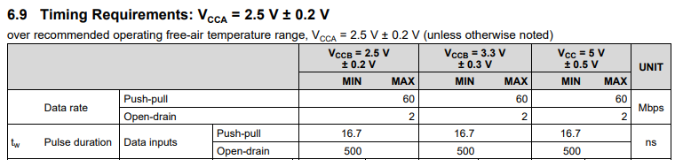

Hi Team,
In TXS0108E datasheet, I saw Data rate - Pushpull max is 60Mbps, does that mean if the output is push-pull method, the output data rate is 60Mbps max, meanwhile, if the output is open-drain, the output data rate is 2Mbps max, right?
