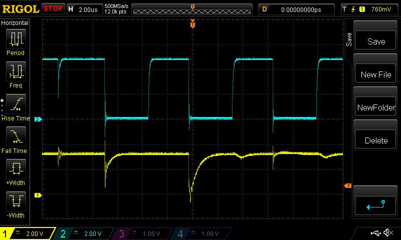

Good day,
I have two LSF0204 in my design. They are used to translate UART and I2C levels: from 5v (MCU) to 3.3v (sensors/other MCU).
I'm having a problem that they stop functioning. I ordered 2 spares but they have also now died.
The devices are solder on to a PCB with lots of other ICs and it's only the LSF0204 that keeps breaking down.
My question: Is there a specific design criteria that I have missed?
Best Regards

    Please send out the schematics and what do you mean by 'stop functioning' and 'has died'? Any scopeshots will be helpful on the Vcc and IO ports.
  • Thanks for your fast reply, that is much appreciated.
    The schematics is exactly as figure 6 in the data sheet. Rpu = 1kohm on both sides, located less than 5mm away from unit. PCB track from MCU to LSF is around 25mm and from LSF to sensor it's around 1200mm (1.2m). The second LSF have only 20mm from unit to sensor(located on the same board).
    Table 2 in the same data sheet indicates that UART is possible with LSF0204. Is that wrong?
    Please see attached scope for 'broken' behaviour. Blue is MCU(5v) side, Yellow is sensor(3.3v) side. The unit is not able to hold the signal low.
    They where perfect copy of each other when the unit was working.
  • If I had to guess, I'd suspect that some overvoltage or overcurrent broke the device.
    But we don't know where that might come from. Please show the actual schematic.
  • Problem solved.
    A small background if someone googles this in the future. I have two LSF0204 in my design: one was never working and the other was working perfectly for around one week before it died.
    After replacing the unit with a new one it was working but around one week later died again. Due this we thought there was a problem with the LSF, it was not.
    The actual problem was a floating enable pin (neither connected to ground or Vrev_A) which caused this.
  • Excellent, thank you for your valuable feedback. I beleive it will be helpful for the community.
    Yes, the active CMOS inputs must never be floating due to this reason.
