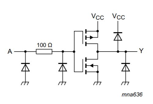

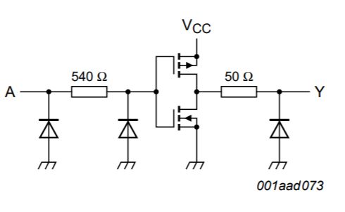

Hi all,
Customer want to know whether we have input and output resistor of SN74LVC1GU04, which will influence the output driver current and input impedence match.
Below is the block diagram of 74LVC1GU04 and 74AUP1GU04
1. 74LVC1GU04
2. 74AUP1GU04
