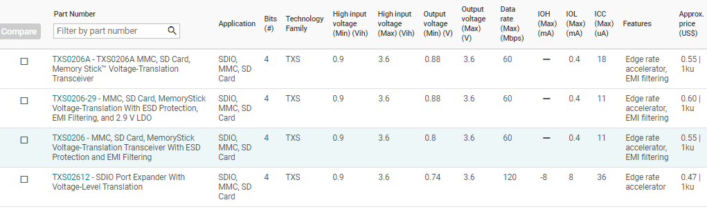

my customer is searching for an 4bit SDIO  level shifter with expander solution,
now they are consider TXS02612 , and seems this device is a good fit.
could you kindly help to check if this device suitable or not?
per my quick check their are 4 devices are 4 bit SDIO level shifter, but looks like only TXS02612 have expander function,
is there's any solution better than TXS02612 and fit customer require and why?
thanks in advance!
Andy
  • Hi Andy,
    That would be the best solution for SD card level shifter with expander functionality. Please note the speed of operation ( CLK signal 60Mhz ) and ensure that it will be compatible with the system requirements.
