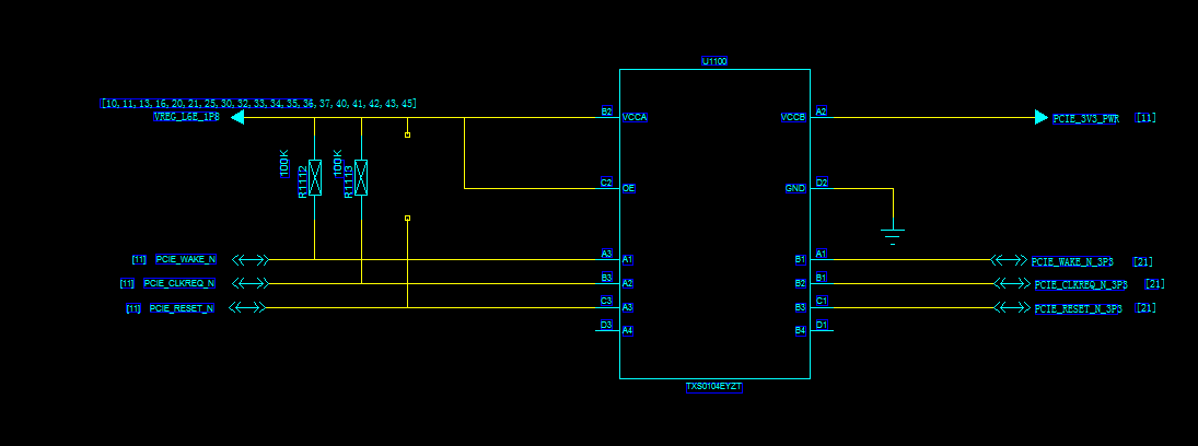

Please help review the schematic below,suspend we want to transfer the signal from PCIE_RESET_N_3P3 to PCIE_RESET_N, and received by controller, when PCIE_RESET_N_3P3 is high, controller received high signal, when PCIE_RESET_N_3P3 is low, controller received low signal, but if we suspend  PCIE_RESET_N_3P3,  controller also received high signal, I think it's an abnormal status.
So could you give us some advice that when PCIE_RESET_N_3P3 suspend, controller can receive a low signal. (We have tried to use PullDown resistance, but it doesn't work.)

  • Hi Derek,
    We do not recommend using external pullup or pulldown signal on TXS/ TXB.
    The TXS have internal 10k pullup resistors and hence the default IO status will be high to their respective Vcc sides. i.e A ports to Vcca and B ports to Vccb.
    In order to have low, the OE pin has to be engaged/ asserted by which the IO ports are disconnected from the 10k pullups. With a very weak pulldown ( 100k), the IO ports will be low.

    So could you provide some advice for my application, I want to use the IC for normal level shift, and controller need  receive  a low signal when PCIE_RESET_N_3P3 suspend, Thank you.
    Or could you provide a suitable IC for reference, Thank you.
  • What exactly does "suspended" mean? Does the power supply on that side also go away? Is there a control signal that indicates this state?
