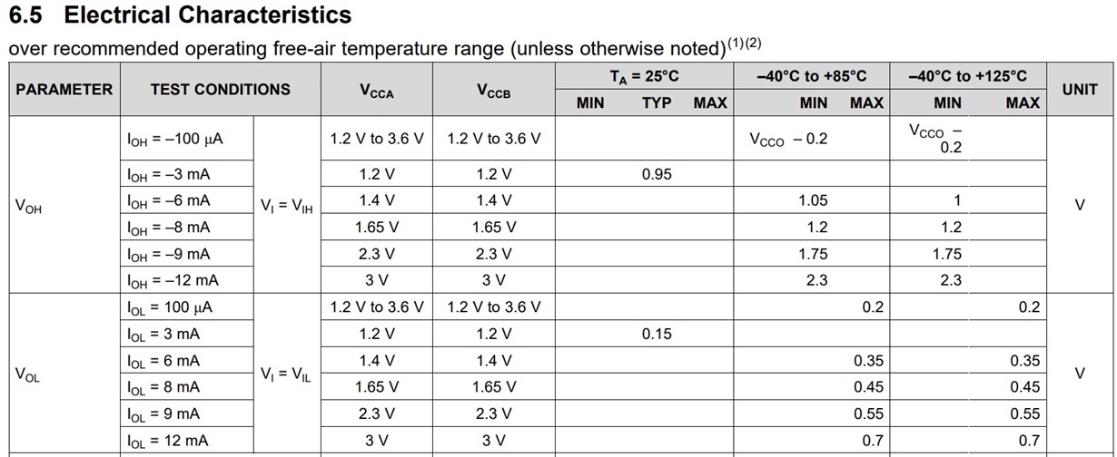

Hi all,
I have a question on SN74AVC8T245.
The test conditions for VOH and VOL in the data sheet are -100uA (VOH) and 100uA (VOL).
What is the VOH and VOL for -500uA and -300uA? Is it the same as 100uA?
I have one more question.
I want to connect SN74AHC1G14 after SN74AVC8T245.
I have checked the data sheet. When VCC = 3V, VOL of SN74AVC8T245 and VIL of SN74AHC1G14 cannot be connected.
Is this understanding right?
