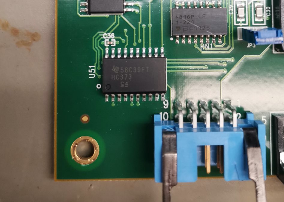

Part Number: SN74HC373
see below. The Texas map logo is not filled by laser engraving. first time to find this chip from contract manufacturer.
Do you have your shipping label or the label on the tape or reel this part came in? This will help quality be able to trace this part down.

This chip's problem is, it won't latch with proper inputs. But once I powered down and grounded these pins, it back to normal.

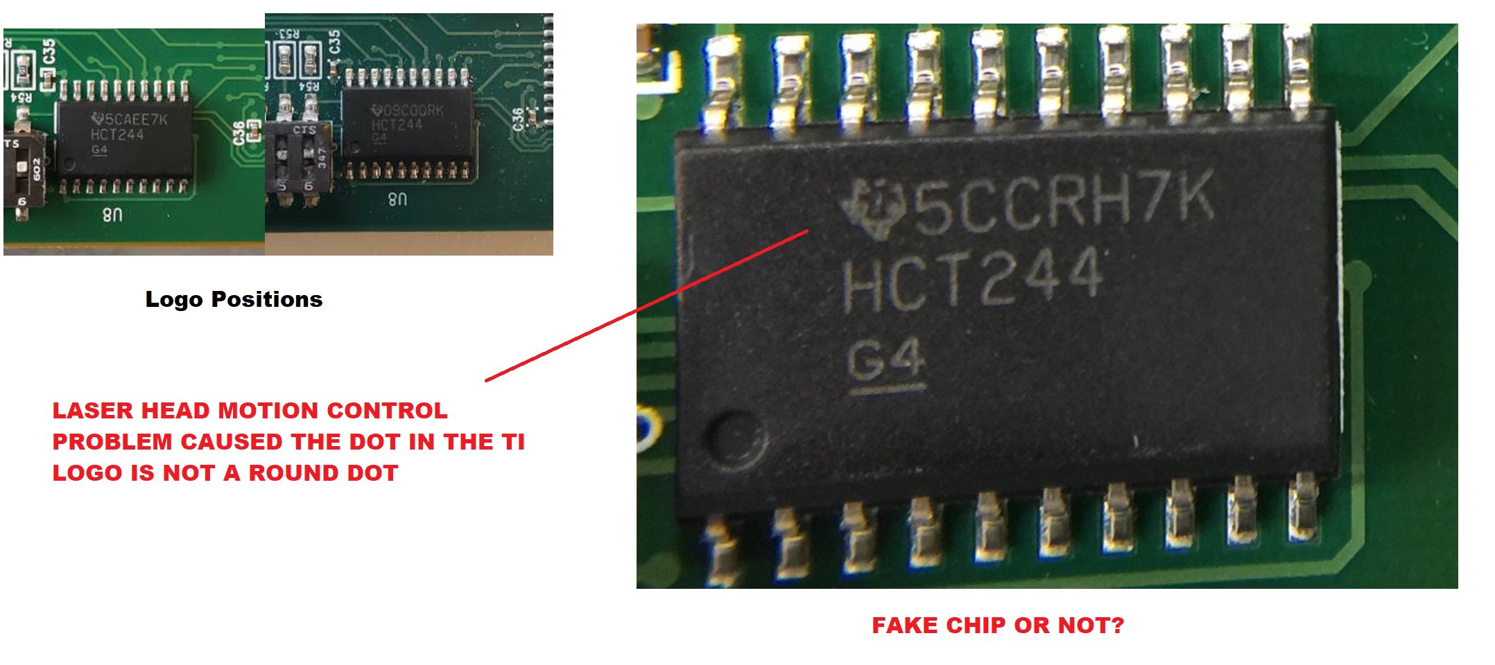

Yes. I noticed that on each datasheet TI says changing the marking without notice. I have another chip looks strange, too. See below
there are some differences about the other chip:
1. DOT area depth, the suspect has a shallower but steep wall ------------ package molding issue: does TI or TI's vendor changed package's molding to make different dot area.
2. The surface of the package, the suspect has a smooth surface
3. The laser engraving depth, with same ambient light, the reflection shows difference: the suspect has little/no reflection and you couldn't read the chars of the marking. I doubted it's caused by lower power laser engraving.
I would need a shipping label from you to find out anything. You can also reach out to customer support as they might be better able to help you with this.
