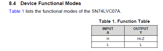

Is there other solution that is P2P to SN74LVC07APWR, but output can be HIGH instead of High-impedance?

The function you are looking for is a buffer. We unfortunately do not have a buffer that would be p2p with the PWR package. Would you be okay using an inverter?
