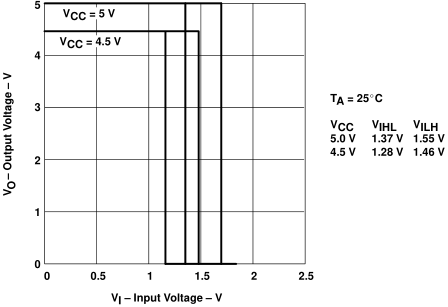

    LV1T at 5 V behaves pretty much like AHCT.
    An 1.8 V input signal will be read as high (typically), but the input PMOS transistor will be partially open, which results in a shoot-through current:
    And there is a little bit of hysteresis. It's not as much as with a proper Schmitt-trigger input, but VILH is dangerously high:
    (from SCAA034)

  • I do not know how the thresholds change with temperature. This has to be determined experimentally. And I fear the safety margin is already too small.
