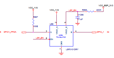

What are the values of Voh(min), Vol(Max), Vih(Min) and Vil(Max) of LSF0101DRY (1-Bit Bidirectional Voltage Level Translator)?
Note: 1) Could not find the values from the datasheet.
2) Schematics section is shown above
The pull-up resistor on the B side is missing (unless GPIO_1 is always driven by a push/pull output).
The LSF is a passive switch and does not have VIL/VIH/VOL/VOH levels. See LSF0102 The value of VIH VIL VOH VOL.
The voltage at VREF_A is near the switching threshold of the pass transistor. Assuming that the direction is from B to A, any voltage above 1.8 V at B will result in a high output at A, and any voltage below 1.8 V at B will result in that voltage at A.
