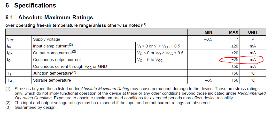

Hi expert,
My customer would like to know the peak spec. for continuous output current as shown below. Thanks!
Sheldon

Hi Sheldon,
Peak current should also be held below the circled Abs max spec.
