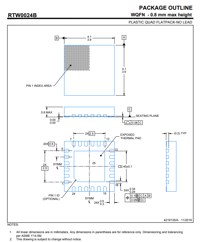

Part Number: TXS02612
From your datasheet:
http://www.ti.com/lit/ds/symlink/txs02612.pdf
Pg 21 and 22 both have mechanical drawings that are different. Which one should I use for the 24-QFN?
thanks!
Erik

Hi Erik,
All packages that TI uses can be found under the following website:
http://www.ti.com/support-packaging/packaging-tools/find-packages.html
The package you're looking for is under the Quad Flat No-Lead package (QFN) section. From there, you will be able to find the RTW package drawing.
Thanks!
Chad Crosby
Hi Erik,
So it appears that the blue package diagram actually is the most up to date version of the package drawing, and I've went ahead and submitted this document to get fixed.
Thanks!
Chad Crosby
