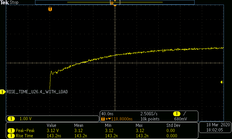

by the way its a 5V CMOS 1 pulse per second timing signal from a source--which is used as a clock reference in my product.
I have used SN74LV1T34DCKR to level shift and buffer to 3.3V CMOS before feeding my CPLD.
This is indeed a slow signal; it requires a Schmitt-trigger input (which would delay the rising edge at the output) or a translator with a lower-voltage input (which cannot be footprint compatible).
