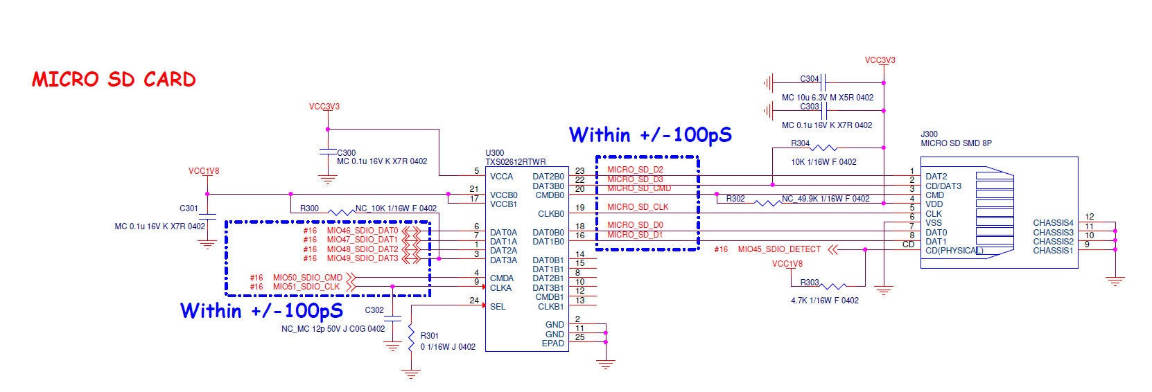

Dear Team,
Can you help on double-checking the below schematic?
BR
Kevin
Hi Kevin,
In the above schematic, I see you plan on supplying the SD Card with 3.3V. If this is the case, then VCCB0 will also need to be connected to this same source (VCC3V3).
Other than that, I don't see any problems with your design.
Please don't hesitate to post back with any other questions.
Thanks!
Chad Crosby
Kevin,
If your A side signals (pins 1, 3, 4, 6, 7, 9, & 24) are referenced to 1.8V, then this is the correct change.
Thanks!
Chad Crosby
