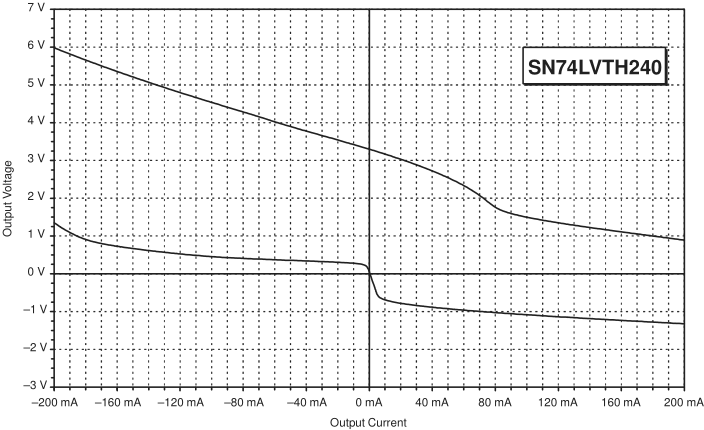

SN74LVTH16245A: VOH Graph
Part Number: SN74LVTH16245A
Hi Team,
My Customer would like to know if there is a data that VOH will be 2.4V for SN74LVTH16245ADGG. The datasheet just shows 2V at 32mA, is there a voltage/current curve that shows output drive voltage vs drive current. Assuming with VCC at 3.0V, to get 2.4V at the output, the source current will need to be less than 32mA, maybe 24mA
