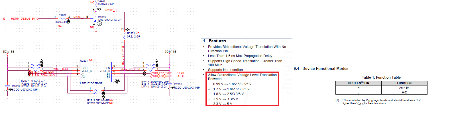

Dear Team,
Now we use 3.3V transfer to 3.3V as below circuits.
But in spec, there’s no allow Bidirectional Voltage Level in list.
Furthermore, in function table description indicated that “Vref_B logic levels and should be at least 1 V higher than Vref_A”
Can you help to check the circuits ok or not?
BTW, can you provide the IC inside block diagram?
