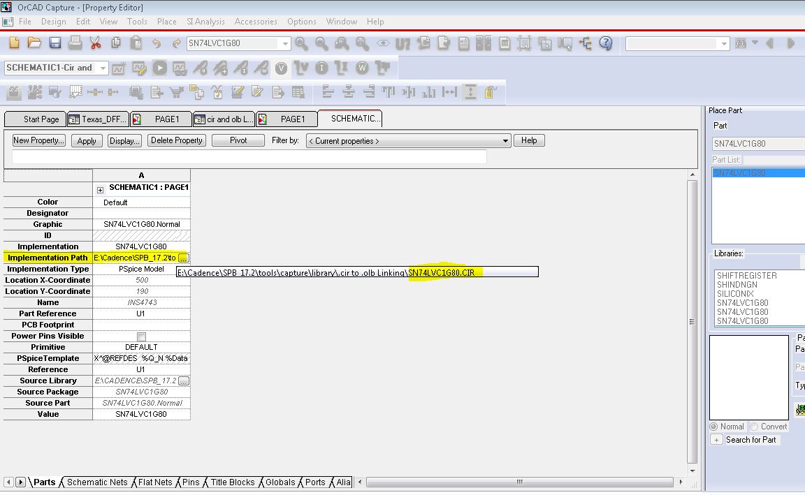

Hi Mark,
The .CIR file needs to be linked to the .OLB file inside of OrCAD. The customer will need to open the properties of the SN74LVC1G80 symbol, and link the .CIR file under the Implementation Path field.

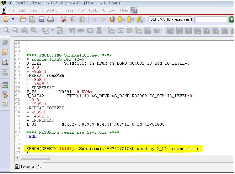

Hi Chad ,
I have proceeded as per your instruction to link .CIR file to the .OLB file inside of OrCAD.
But still its showing error while simulating.
Please help me with a solution.
Attached the error screenshot and screenshot showing the .CIR file linked under the Implementation Path field.
take a look.
KAMESH J

Hi Kamesh,
When linking the .CIR file to the .OLB file within OrCAD, you'll need to do that within the Simulation profile as well. Under the "Configuration Files" subsection, you'll need to select the "Library" Category. Once there, click browse and locate your .CIR file (you may need to change the filetypes on the browse window to "All file types"). Once you've located your .CIR file, you'll need to click the "Add to Design" button, and then "Apply".
On further testing, it seems that our current flip flop models are incompatible with PSpice, and I'm working on fixing these models as soon as I can. These models should still work on TINA-TI.
