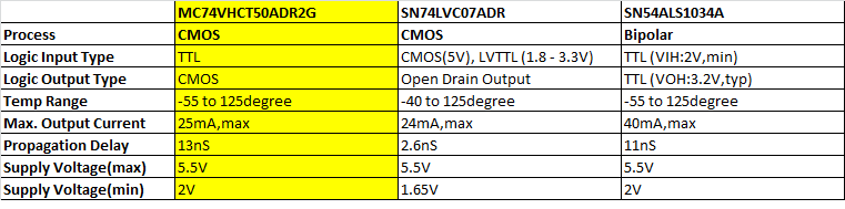

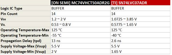

Customer is looking for p2p compatible device with On-SEMI MC74VHC50ADR2G.
We found the SN74LVC07ADR could compete with as comparison table here. It looks the variation of the VIH and VIL is not good on SN74LVC07. i'm not sure if it is ok in application? or Is there more suited one you can suggest? Very thanks .
