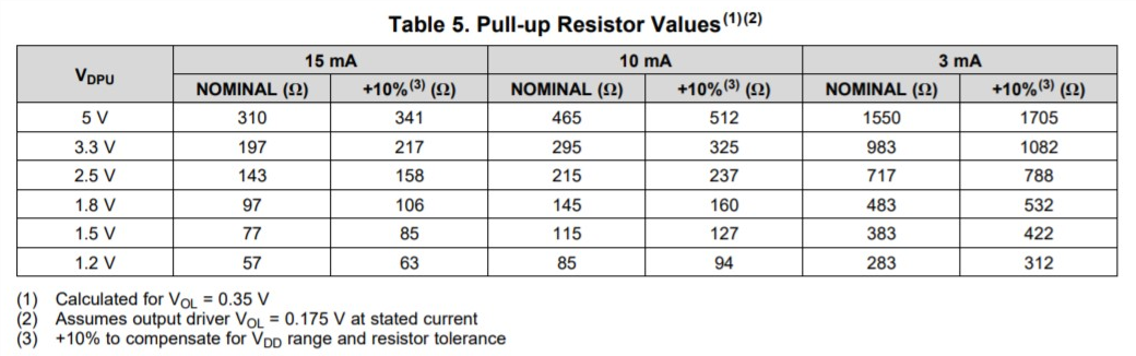

We suppose to use LSF0102 as a level shifter of MDC and MDIO.
I attach a block diagram image.
Could you please review it and give me a feedback for any concern.
BestRegards
Hey Na,
Everything looks good so far, I would add bypass caps in the actual schematic. 57 ohms seems a little small, are you expecting high data rates?
Hey Na,
Yes I recommend using larger resistors especially for that speed. This video below does a great job explaining how properly size the pull-ups:
