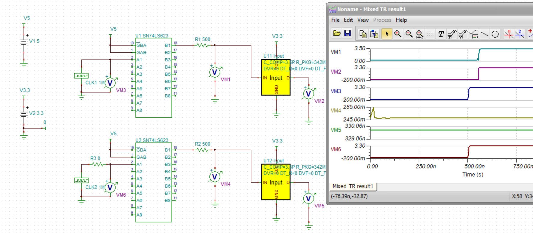

SN74LS623: Tina V12 bug
Part Number: SN74LS623
Other Parts Discussed in Thread: TINA-TI,
This is a TINA 12.1.30.114 SF  (x64) bug. 74LS623 can pass TTL signal correctly when "A1" connecting to a clock directly. But a 0 ohm resistor could screw it up!? Very absurd. Please help me and send me the TINA V12 update if the bug is solved.TinaBug_NoGlichIf500.TSC
