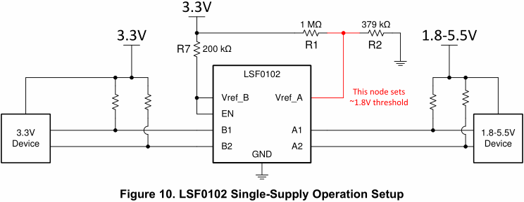

I would like to apply LSF0108 in my design.
In the datasheet of LSF010X, minimum voltage input for Vref_A is 0.95V.
But in the EVM application guide, the voltage of Vref_A is 0.9V in single-supply operation. www.ti.com.cn/.../slvub53.pdf
I am confused if the single-supply operation is correct.
Or can I use single-supply operation in my design?
Thanks!
