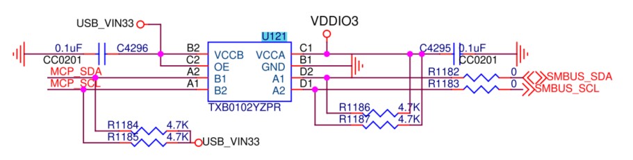

Hello E2E,
What is the output state or impedance at A side when VCCB and OE is floating but VCCA has bias voltage?
Sincerely,
Jason
  • The datasheet says:
    The TXB0102 device has circuitry that disables all output ports when either VCC is switched off (VCCA/B = 0 V).
    But when VCCB is floating, then C4296 might have enough remaining charge so that there is a voltage high enough to power the device.
    Please note that the TXB I/Os do not work with pull-up resistors and cannot be used for I²C/SMBUS. The TXS0102 would work in this situation.
  • Hello Ladisch,
    Thanks for your reply.
    Assume we change to TXS0102 at the same configuration, what if Vccb is floating and fully discharge, what is the A side pins impedance while VCCA is still biasing?
    Sincerely,
    Jason
  • The TXS0102 datasheet says:
    VCC Isolation Feature: If Either VCC Input Is at GND, Both Ports Are in the High-Impedance State
