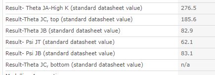

My customer would like to know the complete thermal information for the SN74LVC1G126DCKT device. The data in the datasheet is not complete. Can you share with us the complete information?

Hi Renan,
Do you know what the customer is doing with the device that requires additional thermal information? It's very rare to see a single channel logic device used in such a way that the thermals become such a large concern -- especially beyond just theta_JA.
The values you requested are here:
One additional piece of information is located in our FAQ here:
