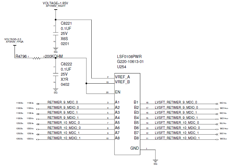

Customer found an issue when using LSF0108 to shift 3.3V to 1.85V. Circuit:
Circuit:

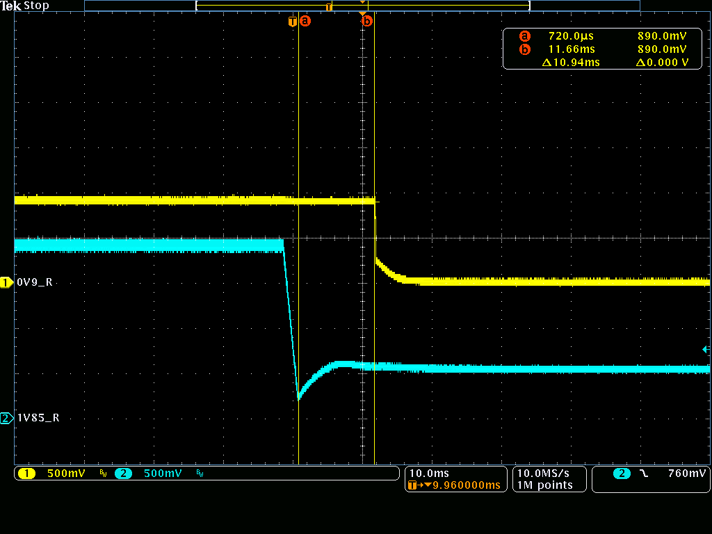

When system under S5, 1.85V will be shut down, but 3.3V won't.
So we observe that there is leak current on 1.85V when S5

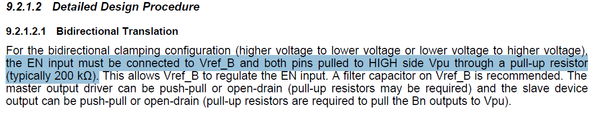

According to LSF0108 design note, enable pin should tie to Vref_B which is high side.
But Can we connect Vref_B with low voltage(1.85V)?  so the level shifter can be disconnected when 1.85V is shutted down.
