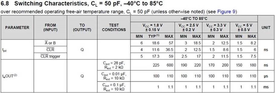

SN74LVC1G123: what is the minimum pulse duration over that temp range?
Part Number: SN74LVC1G123
Its datasheet shows (below table) that with a 10kOhm resistor and a 0.1uF Capacitor at Vcc=1.8V, the pulse width is typically 1ms and max 1.1ms over the -40~+85C temp range.
My question now is: what is the minimum pulse duration over that temp range?
