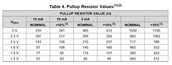

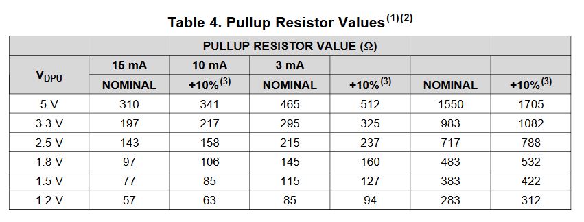

  1. Page 14 says   “Also Vref_B is recommended to be at 1.0 V higher than Vref_A for best signal integrity” .  Is this an issue? I am using 1.8V and 2.5V.
  2. I am not sure I am using correct termination.  I am using MDIO, MDC, MARWELL Gigabit Ethernet Transceiver to a FPGA. Any Idea/recommendation please?  I picked up the below resistors from the table on page 15. Are they correct?   Please see below.
Thank you in advance for your support!
Errol
  • Hi Errol,
    I would highly recommend that anyone who's trying to design with an LSF translator first watch these short videos:
    The whole series adds up to only about 20 minutes, or they can pick and choose which ones they need to watch - each video is only a few minutes long. It would be very difficult for me to replicate this level of detail in a post.
    Please let me know if there are any areas of confusion or specific questions that come back.
