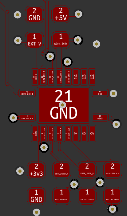

I am attaching the schematic and Layout here.

  • Oscillations happen with TXB/TXS translators when there is ringing on the signal lines; this can cause the edge accelerators to falsely trigger. Typically, you get ringing from a high capacitive/inductive load, i.e., long traces, connectors, or cables.
    How many signals in each direction do you have? Is any single signal actually bidirectional?
  • Hey Clemens, thanks for the quick reply.
    The traces on the board are around 50mm in length. Is it a cause for concern?

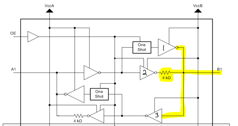

    The TXB translator has this architecture:
    I highlighted everything connected directly to the B1 pin for clarity.
    You can see that there are two outputs connected together labelled 1 and 2 above. Output 2 is always active, while output 1 only activates when a change is detected at the A1 input.
    For any auto-bidirectional voltage translators, you shouldn't be using any series resistors.

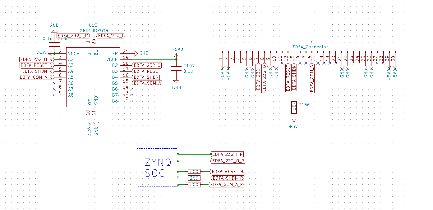

    Your schematic only shows the TXB0108 -- can you also show the resistors and anything else connected to input and output which are having the issue?
  • Hey Emrys Maier,
    Thanks for the reply.I have attached a simplified end-to-end schematic here.
    As you can see, two of the channels (they are used for UART, does not have any series resistor or pull-up/down resitors used with them), still i am able to find the oscillation in those pins too.
    I'm not able to discern the nature of the oscillation properly, since the oscilloscope I'm using is a 50 Mhz one.
    It could be as clemens mentioned due to ringing at input and the one shot getting triggered continuously, but i was unable to find any such ringing at input.
  • The ringing is not at the input but at the output. Because of the bidirectional I/Os, it can be interpreted as a signal edge going in the opposite direction.
    And there is indeed a connector. This board violates the restrictions in section 8.3.3 of the datasheet. As a rule of thumb, TXB translators can be used only between nearby chips on the same board.
  • Hey Clemens,
    That makes a lot of sense, and is most probably the issue. Thanks for your inputs.
